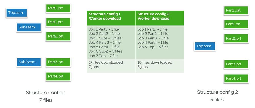

If this is the first publication of your assembly and all its components the number of files can differ according to the assembly structure and also if you are downloading all the required dependencies or only the one required to regenerate the assembly.
So CAD structure has an influence too as you can see below.
Here is a comparison example with only the required dependencies:

@jlecoz I've been working with the same dataset for all of these to maintain at least some consistency in the testing. I understand there would be differences in dependencies later on but I'm trying to have that not be in the mix for right now.
