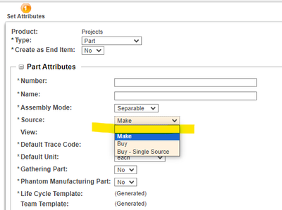

Can we default this value to empty initially, and not to MAKE. Only when users select the dropdown, they should be forced to pick a value because it is mandatory.

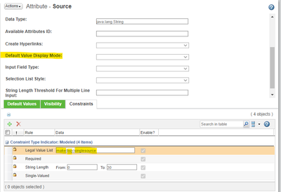

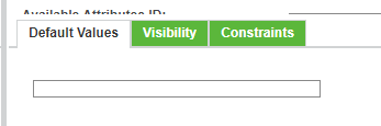

Just remove the default value from the type and attribute management and that's all
PetrH
