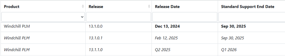

Considering a double hop upgrade from 12.02. to 13.1. I need to stop briefly at 13.0.2 before continuing on but seeing if we can chain this together.  What are some things to look out for? I believe I would need to plan for two target hosts and databases right? Is it just as straight forward as running the upgrade manager twice or should there be deep validation in the intermediate upgrade? In people's experience who've done this, is it 2X or 1.2x harder?

Thanks @BenLoosli and @MikeLockwood. Linking in this thread: Windchill 13 Support End Date. Still digesting info from the conference. Odd that support calendar shows short dates for 13.1.0. Same question why no overlap unless they keep changing dates as they go. Looks like 13.1.2.0 should be out Q4 with 4 year support per presentations. "We will support upgrades from one Supported version to another". Caveat is "Standard Support" only. I need to get off 12.0.2 but do then we are looking 13.1.2 in 2026 just as they switch to yearly version schema. They need to publish more future date information with planned overlaps.
