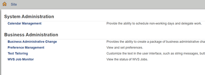

Currently, some of my clients are experiencing issues with Windchill, such as the global search bar not appearing or contexts and libraries not appearing when accessing Windchill after granting all licenses.

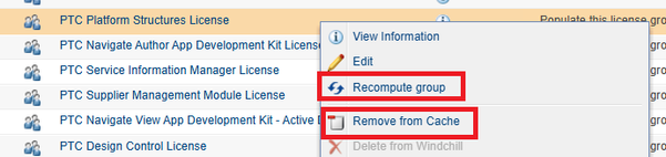

Usually if you assign the profile it is really good practice to remove user from a cache and also recompute all groups that profile access and acl access are refreshed by the latest configuration.
It is common behavior that sometimes it is necessary to do so.

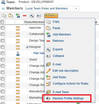

sometimes you have to restore Profile settings on a context from a team management

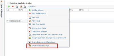

Can you share more info on, the statement "clearing one license will restore normal functionality." ?
When this happens does purge participant cache helps ?

well.... when this situation happened, i can't see the participant management. so i can't do this.

i can't remove participant's caches because when this happened, my windchill can't show the menu like participant management, license management.

This is well know issue with old licenses and some PTC license profiles combination
For example you assign a license that is not used anymore and a profile is disabled. That can case your issue
check following article
CS329469 - Missing links in "Site" > "Utilities" for "Administrators" after importing license files or upgrading Windchill
or
CS322772 - Administrator cannot access ‘License Management’ page after upgrading in Windchill PDMLink
or
CS324730 - Links missing in Site Utilities for Administrator users to Windchill PDMLink

I read all the article that you share.
CS329469 This article seems to be the most similar to my problem.
I want to know the problem that can cause all the participants?
All participants experience the problem not only Admin participant.
I set the property to automatically clear the participant cache and today the problem is gone.
