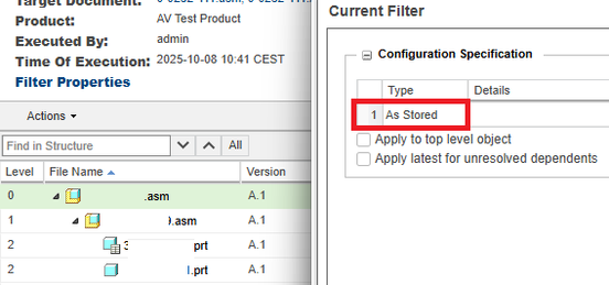

I need to create a query that extract a multi-level Bom based on a specified Number, Version and View (manufacturing/design).
The query that i made, take the latest version of the childs, but i need the "as stored" configuration of that bom in that specific version and view.
I have tried usign Query Builder, but it can extract only Single-level Bom.
I leave at the bottom the query i made
Can someone help me?
Thanks for your support
Best regards.

Hi @EMore
The Query Builder can not call recursively an another report so you can not get the multilevel bom just by the Query Builder.
Why do you not use the Structure BOM Report? it can generate the multilevel BOM with attributes you need.
Otherwise you have to write own function to generate BOM as you need with recursive function.
PS> as stored configuration for WTPart does not exist. So you have to play with the modification time and it is really too complicated.
PetrH
