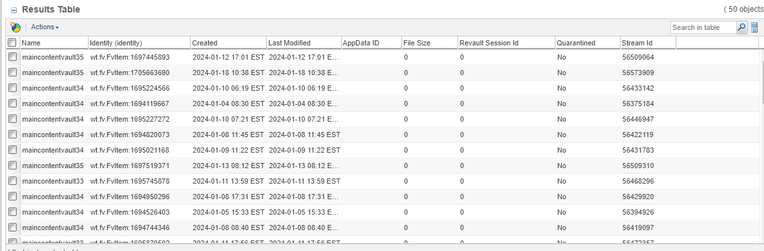

I am in the file stage of my vault move and clean up. There are 0 files in the remaining folders but a Query Builder report show 50 files remaining.
When I executed a vault WContent verification check and everything comes back clear. No missing files. huh? I created a new report to check the FVItems against ApplicationData and it shows that there is no ApplicationData tied to these FVItems at all. Bad data? I would thing so. All show 0 bytes in the DB too. Now this article says that the CommonScheduleQueue should clear those no worries. Except that I waited a day and nothing. These also have existed for many weeks and odd that the timestamps show recent.  I think my only recourse is to remove the offending lines records right? Is there any other thing that can be tied to these?

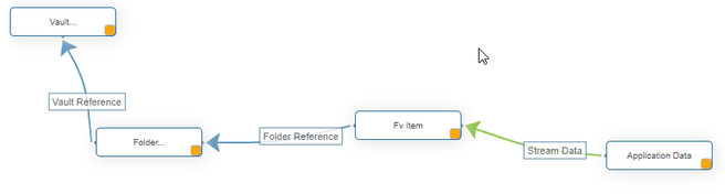

Query ApplicationData for associations to the mainvault.  This article shows the relationships for building the query.
https://www.ptc.com/en/support/article/CS121641

I created this QueryBuilder report to get the data on the 50 FVITEMS:
ApplicationData to FVItem is outer joined so if the FVItem does not appear in the ApplicationData table, it will show nulls. I am also looking specifically at the the vault I am trying to remove which reports to have only 50 items matching this report. Notice AppData ID is null indicating there is no ApplicationData object referencing this FVItem.  Junk data?
