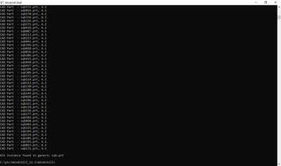

Is what you are looking for?
I wrote and ran a class in Windchill shell as a test.  Seems to work.
I did this using QuerySpec however there are a couple of other ways to do it.
 @RandyJones suggestion of using the CadCollector would not also work.
Hi D-Graham,
Yes, I saw the output and looking the similar type of data. It would be great help if you share the code
