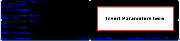

  1. Open Windchill Shell, Run Windchill wt.fv.tools.WContentVerify –checkBusinessObject
  2. Authenticate
  3. Select the type of document that you are looking for:
  4. Once selected, input the requested parameters:

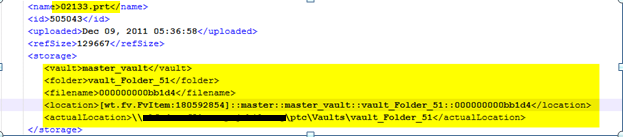

The tool will now output an XML file to the logs directory of whichever node you are on, if in a cluster.
The XML will show you the exact location on the vault of whatever file it is you needed.
5. Go to the vault and find the file.
