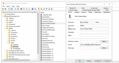

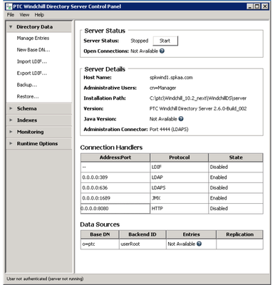

Hi Hussain,
do you need access this windchill directory or active directory for AD , but you need access those.
or for example
