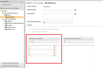

I have bulk data thats why im trying to load instead of doing manually.
Well, there might not be a loader however, a utility can be written to read a file and created the global enumeration.
To prove this out I wrote a utility, GlobalEnumerationHelper2, that contains a method accepts two arguments, Global Enumeration Name and a List<String> of values.
Can easily expand this utility to read a file to get the Global Enumeration's name and the values for the enumeration.
Maybe a CSV where the first column is the Global Enumeration's name and each subsequent column holds a value for an entry. Just a thought.  Lot's of ways to do it.
The code is kind of complicated but once you see the pattern everything falls into place.
The global enumeration itself requires storing 3 entries into the database.
Each value in the enumeration requires storing 5 entries in the database.
So, is you have 10 entries in your enumeration, 3 + (5 x 10) = 53 stores to the dB. Who knew?😀
Run from Windchill shell looks like this:
Results after run:
Seems to work well.
Interesting utility to figure out.👍
David
