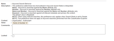

We are on WC 11.0. Our administrator said that "keyword search behavior" only has 4 options: “Name”, “Number”, “Name & Number”, or “Keyword”. I had hoped that he could add "Description"

Our administrator does not what to use "keyword" for some reason. He said this was tried in the past and caused problems. The WTParts sound like the best approach. What are the steps to accomplish this. I was able to create a new WTPart but how do I relate it to the PDF document? Thanks
If you edit that preference for Keyword search behavior, its the other choice. Sounds like they had trouble with SOLR. Ok, yes create the WTParts. Easiest way is to search for all of them, select them, copy. Then go to the Related Objects Tab of the PDF document and click paste in the Describe By parts table. That will create the links.
