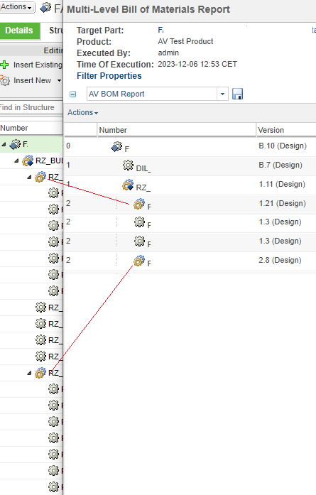

We have a requirement to stop traversing a structure in BOM report if the assembly has part type = inseparable or source=buy when generating a BOM report. The reason is that the buy or inseparable compoents does not have child components in ERP. Can this be done without major customizations?

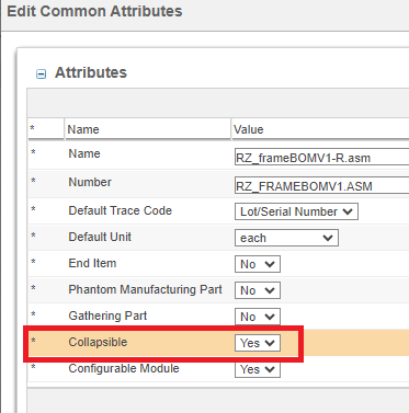

Do you men this attribute?
because OOTB "Collapsible Assembly" does not exists on a WTPart in the PDMLink
If I set this attribute to yes, the report still shows the child components.
Multilevel BOM and Multilevel component report do the same as before the change
PS> it is related to BOM Transformer and Variants not the BOM Reporting.
Collapsible Attribute Set to Yes
Collapsible Attribute Set to No

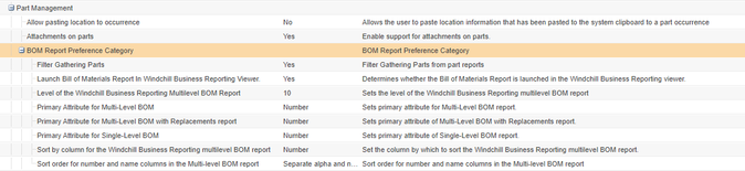

the system allows you just exclude a gathering parts from the report by preference Filter Gathering Parts

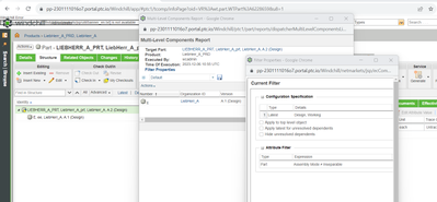

Glad to hear from you again , would you try to set filtering in  PSB before generating the BOM report
Fede
HelesicPetr
(To:Fadel)
Hi @Fadel
I guess that inseparable is set on the assembly, which should be part of the BOM report. but used parts on the lower level of that assembly shouldn't be part of the BOM report.
I know the case and I don't think it is possible to set it by the filter.
One our customer needed same report with different conditions.
I wrote own BOM report for him.

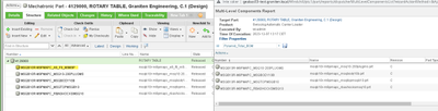

Thanks för your inputs. Yes, I tried to colapse child components by attribute filering which seems to give correct result. However, when generating the multi level component report, the assembly note is not reported. The report does not treat the assembly with hidden children as a component.
HelesicPetr
(To:Pekholm)
Yeah. multilevel component report
it is different story 😄
It really reports only the lowest children and it does not care about the upper assembly(nodes).

Please set the parent part attribute "Collapsible Assembly" as Yes and redo the BOM Report.
It should meet your requirement I think.
Best Regards
Hari
HelesicPetr
(To:Hari_Vara)
Hi @Hari_Vara
