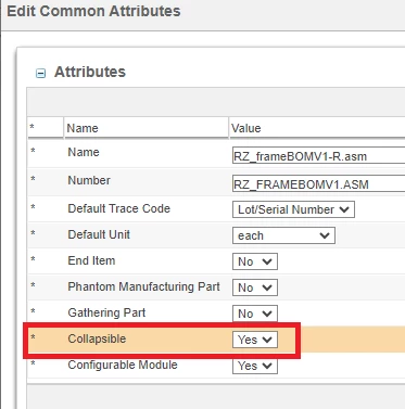

Do you men this attribute?
because OOTB "Collapsible Assembly" does not exists on a WTPart in the PDMLink
If I set this attribute to yes, the report still shows the child components.
Multilevel BOM and Multilevel component report do the same as before the change
PS> it is related to BOM Transformer and Variants not the BOM Reporting.
Collapsible Attribute Set to Yes
Collapsible Attribute Set to No

Please set the parent part attribute "Collapsible Assembly" as Yes and redo the BOM Report.
It should meet your requirement I think.
Best Regards
Hari
HelesicPetr
(To:Hari_Vara)
Hi @Hari_Vara
