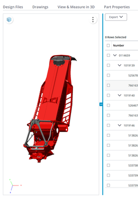

ThingWorx Navigate is using the ThingView Widget to display CAD-(Creo View) data in the browser. (as seen in this picture)
You cannot directly view the CAD data in a browser without some Widget/app to render the data.
In ThingWorx Navigate you should bind a service like "Part_GetDynamicStructureRepresentation" to the "ProductToView" property of the ThingView widget.
There's also a help section about the ThingView widget in the Navigate help center:
https://support.ptc.com/help/thingworx/navigate/r9.4/en/ThingWorx_Navigate/Customization/webGL_extension/cv_webGL_extension_book/configuring_your_thingworx_server_to_work_with_the_thingview_widget.html#
