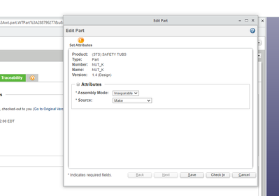

How do I attachment documents like PDF or word documents to the WT parts after I create them?

Then your system admin needs to modify Windchill preferences to allow secondary content.
In Organization or Product preferences, have them look for Part Management and then set Attachments on Parts to Yes.

Checkout and Edit the WTpart
On the first screen, edit Next
On this screen, you can browse and upload any related documents you need.
When done, check-in the WTpart.

The next button is grayed out, so I am lost.
By default, no files get attached directly to WTParts and this preference should be understood and discussed carefully.
The norm is to associate (not attach) WTDocuments (of two primary flavors) to the WTPart.

I may have access to change it.  How do I get in there to change to YES.
Key to this is precise terminology.
Files are "attached" as content for example to WTDocument objects.
Separate WTPart and WTDocument objects can be Associated, as Ben notes below.  Each is still independent but associated.
