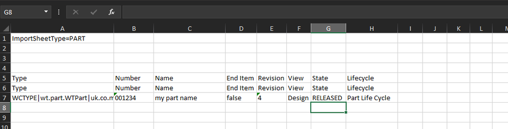

I am using Import from Spreadsheet to update units of measure on parts. Seeing as I was only changing those attributes, I left State and Lifecycle blank. Odd thing though, it seemed to move all the parts to the Released state. Strange that it would do this since if I want to hold to previous state, I have to look it up for each part and put it in the update file. One would assume that if I did not proved a value, don't touch it.  Anyone else seen this? Does not appear to be documented.

It works for me as long as the spreadsheet has a Lifecycle column as well as the State column. When I removed the Lifecycle column I get the same weirdness like you described.

This is what I have
I can fill out the default Lifecycle Template but if I have to put the current State in there, it would require a lot more work. The columns exist, are you saying that just the Lifecycle needs a value? or both?
Both unfortunately

I tried it with just the Lifecycle template included and I "think" it worked and did not change the state. This brings me to my next point...

Maybe change your way of working, to not have extra-work researching the lifecycle-state "State".
When you have a set of WTPart or sub-WTPart-numbers, search for them in the Advanced Search in the number-field, divided with semicolons.
You get all your WTParts and can download them into an exportable spreadsheet.
Here, your "State" is filled. (Didn't test so far what happens when you're not changing it. Maybe one Iteration goes up?)
Now, only change the desired cells, save and import again.
