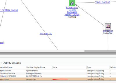

I have an attribute called 'sapnumber' that I use in both wtpart and cadpart.
When a user creates a part and publishes it, they initiate an ECN and start the process of publication. I would like to update my sapnumber within the ECN process using an expression.
The expression will be: sapnumber = (part number + -AA). However, I am constantly receiving an error with this expression.
The expression I got the error from is attached.
Can you help me?

hello fadel,
I can't actually get to an error. expression skips without executing its function.

hi , you may enable below loggers , to see what the WF is doing :
log4j.logger.wt.workflow.definer=DEBUG
log4j.logger.WF_EXEC_EXPR=DEBUG
log4j.logger.wt.workflow=DEBUG
log4j.logger.wt.workflow.engine=DEBUG

Hi, @Hari_Vara @Fadel
I prepared the code and it works.
I take the first digit of the version number with the epm number and write it to an attribute.
(Description lines are in Turkish.)
