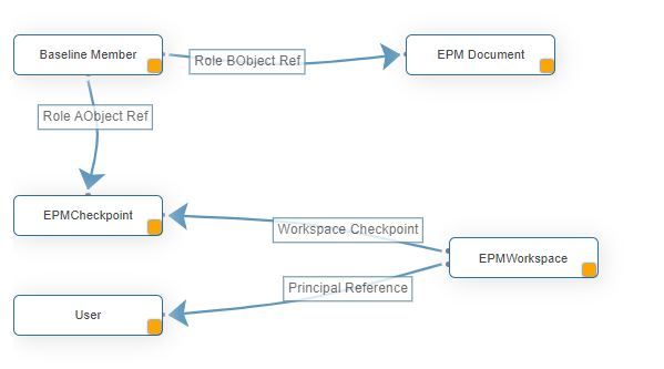

That report give every EPM Object in every workspace which is too much data. Do you know if it can be re-fined to only show User Workspace names? so i can get a list of all the workspaces we have in Windchill?Windchill_WS_Report.JPG
HelesicPetr
(To:SJ_8287651)
@SJ_8287651

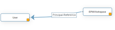

Remove all tables from EPM Document to EPMCheckPoint

I have used that report in this link many times, I have used it on 11.1 and 12.0. The first download is the 12.0 one, the second was for 11.0. Read Steve's comments in the replies to get the right version.
By default, it lists ALL files in ALL workspaces, but you can uncheck some of the buttons and get only the workspaces. It does not report empty workspaces. I had to use SQLdeveloper and look at various tables to get empty workspace information and tie it back to a user. I'll see if I can find my notes on what I did to do this. (I also need it for my next upgrade to 12.0 in the next few days anyway.)
I found that only having this bring back only the workspaces in Windchill
