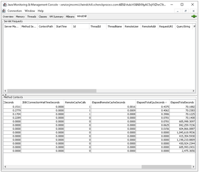

Ultimately, the answer may be to throw more resources at it.  But it feels like the slow reports are a symptom of an underlying issue.
You can use JConsole (windchill wt.util.jmx.SMJconsole) to try to identify what is running during these lockups.  Select the Windchill tab to see what is running at the moment.  The ElapsedTotalCpuSeconds column may be useful.
It may not be Windchill/DB related.  For example: Antivirus scanning can consume all processors for a period of time.  If Defender antivirus and a third-party antivirus are both running, it can lock up a server for hours.
PTC Tech Supt's performance team can help direct you to the source of the issue.
