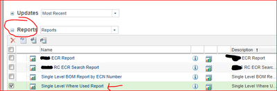

Hello Experts , Is there any way to generate " Multi Level Where Used Report" in windchill similar to "single Level Where Used Report" ?

Sorry if I am lost. The reports on the structure page are not where used reports. They go down not up. The Where Used tab and table are multilevel. Short answer is yes if you mean column differences. The only real difference between these reports would be how many levels you recurs up the structure.
sorry for the confusion, i was referring below report.

Hello @mbabu,
No, there is not possible to create multilevel report in query builder (Report Management).
If you need multilevel report you need to crate own customization to achieve your needs.

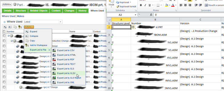

Hi @mbabu
The report does not exists OOTB.
As @avillanueva mentioned.
You can go to the Where used tab on WTpart or Related Objects on CAD model
You can export the table to several file types,
Then you can work with the output and get all the highest assemblies.

Thank you PetrH,  the shortcoming of about option is it wont capture the "qty " of item, Unlike Single level BOM report . that's why I was checking do we have any way to fetch multilevel BOM with QTY similar to single level BOM report . It was there in Windchill in past , but it got removed [ article -CS83061] . Thank you again for the helping hands!
