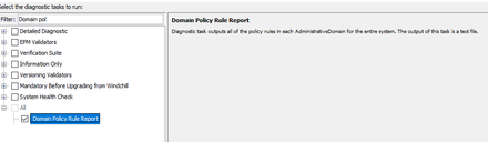

HelesicPetr
(To:PK_10753886)
Hi @PK_10753886
First you should know How ACLs Work
For documentation I would advice you to try WINDU task Domain Policy Rule Report to get all ACLs from your system, and you can process the output to excel
It is good overview what ACL and where are defined.
PetrH
