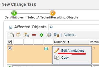

Check if the annotation exists on the object
Add the object to a Change Task
And  right click on the object in the affected table
Edit Annotations

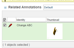

In Associated Annotations wizard use the green +
Select your annotation and click ok

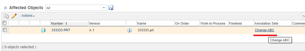

Result in the Change Task Affected Objects Table
Hope this can help.
