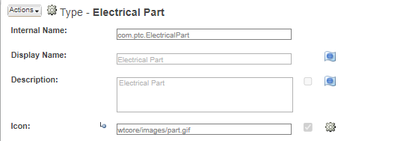

Hi Guys,
When we create a new part in type and attributes we get a com.ptc right i want to know the difference between of with com. ptc vs direct name.
Refer the screenshot

Hi @Amirtharaj_K
If you create own subtype, you can use any internal name what you want.
You don't have to use com.ptc or any other domain.
There is no difference. if the name is com.somethingor just something.
