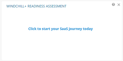

Assuming the upload was successful, how long should it take before the results are available on the Performance Advisor website?  It's been 2.5 hours since the upload finished and I'm still not seeing anything.
2023-09-07 16:00:19,283 main [DEBUG|com.ptc.wa.wcu.wnc.WinCUPluginRunner|WinCUPluginRunner] WReadE Report Send Status : SUCCESSFUL

@tom
The above gadget indicates that the reports are available and now you can perform/view the assessment.
You need to click on the above link "Click to start your SaaS journey today" to view the Windchill+ assessment results,
There are 3 questions which need to be answered before you see the Overall SaaS assessment result.

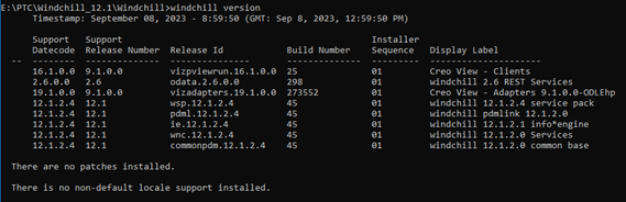

Thanks!  Next question.  I have an 'out of the box' install of Windchill 12.1 2.4 that I'm testing this on, and the assessment is telling me that there are hundreds of customizations present.  There certainly are not.  Will a later CPS trip up this tool?  The tool is claiming that my 'Current Release' is 12.1.2.0, but it's actually 12.1.2.4.  Would that possibly cause this behavior?

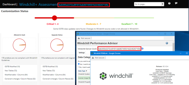

Can you confirm the GUID/Windchill Server ID that you picked is the correct one and of the server that you are looking for?
TomU
(To:sgaikwad31)
Yes, they match:

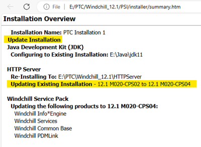

To better test this out, I just performed a fresh, clean install of 12.1.2.0 and then ran the WReadE tool.  Same result.  Tool is claiming there are all kinds of customizations and alterations to the database.  I then installed CPS 12.1.2.2, changed the GUID, and ran it again.  Shows even more customizations now.  Finally, I installed CPS 12.1.2.4, changed the GUID again, and ran the tool for the 3rd time.  Pretty much the same result as the previous run.
Something is very wrong with this tool.  I'm going to open a support case and see what they say.
