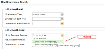

Asking for references how have you operated in the following situation.
Version I use is 12.0.2
In BOM-transformer, MPMlink:
If parts is created by mistake to manufacturing view that should be in design. (Accidentally click duplicate with propagating, when I should just allocate the design as design to manufacturing side)
What is the back up plan?
Is it possible to just remove the manufacturing views of those parts if you detect it immediately? Will the connection link between design - manufacturing view even allow it (admin rights).
This is important because if manufacturing view have been created, it will always use it instead of design, and this is not what I want by accidentally created components.
Thanks in Advance.

Thanks for the answer. If I'm right reassign view can only be used when only one view exists for the part number. In my example if I click "duplicate with propagating" by accident, there is design + manufacturing view for the part. But yes I can remove them, but need admin rights.
Can you look for my latest question in this topic. Can the "duplicate with propagating" default option be removed from BOM transformer?

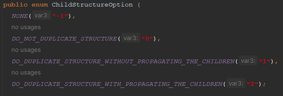

To your question, I can not locate any configuration option in the system.
So the options are not covered by configuration.
I've just found a class where the options are defined
com.ptc.windchill.associativity.client.ChildStructureOption
So rewriting the class could be a way but I can not recommend it because who knows what that change could case.
PetrH
Yes, it may not be the best idea to modify the class. I will continue to explore potential solutions to this issue. I will update this topic if I manage to find a resolution.

Hi, edited a bit my original post.
But I got a idea that solves my problem in most cases. I tested that I can remove manufacturing view part right after it is created. It does not raise an error that there is an equivalent link between the design view. This is Good thing for me.
My main concern was that someone click in MBOM transformer the child option " duplicate with propagating " and it would create many unnecessary manufacturing view objects to my system, I came up with idea that why not remove the default option from the menu, because I'm not planning to use it. I always use do not duplicate or duplicate without propagating.
How do I remove this default button?
Any help related to this?
