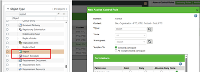

I am using Windchill PDMLink Release 12.0 and Datecode with CPS 12.0.1.1
I would like to set permissions to Data Monitor for a specific user. What permissions do I need so that this user can view reports and download data monitor executed reports. Please advise. Note I didn't find any details in KB.

you can enable logger wt.access.evaluation.report , try to run action in the logs you will what permission is required
I would  expect types to grant permission should be Data Monitor and Report (Maybe report template) too
