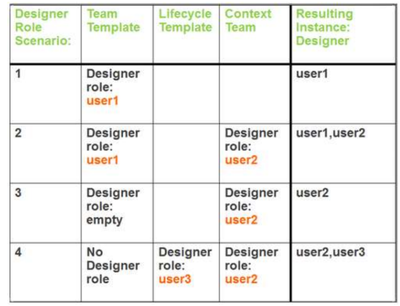

Remind me please. Is the Phase Access Control on the Lifecycle for a Role the Role in the Context Team or is it applied to the member on the role in the process?
What I am wondering is if a named role has edit at a lifecycle phase, do all members of the context team also have edit at that phase or is it just the members of the process itself that are in that Role.
I think it's just the process members, just want to check.
PTC is not clear on this.
Thanks.

From what I know at this point (unless someone chimes in) is that the Phase control only applies to the members of the process at that phase (state) and not the context team role of the same name.
It is a more focused why of applying access when needed to just that process object and not applying it to all process objects of the same type at the same state for all users in that Role.

The ACL defined on the lifecycle is depended on the process role, not the context role.
So you can manage an access individually for an each workflow process.

Yes, that does seem to be the case. It's also rather odd how PTC uses team templates and context roles. If there are used in a role "approver" in the team template it will pick those people for the "instance" (workflow) but it will also add anyone else it finds in that same named Role in the context team.
So, if we have phase access in the lifecycle for a Role, we would need to use a different named Role in the context to give blanket access to the workflow object at that state.
