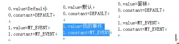

1.】As suggested by PTC,I have to modify the related resource file in this directory firstly:
D:\ptc\Windchill_9.1\Windchill\src\wt\workflow\robotsthe name of the resource file is sychEventResource.rbInfo.
Both the synchEventResource_zh_CN.rbInfo and synchEventResource_zh_TW.rbInfo will have to be modified at the same time.Just like this:
sychEventResource.rbInfo:
![O_Q9CT@]X]0@C2GCG}B@VAJ.jpg](https://community.ptc.com/legacyfs/online/14926_O_Q9CT%40%5DX%5D0%40C2GCG%7DB%40VAJ.jpg)
synchEventResource_zh_CN.rbInfo:
![7]A$D{{%WUK2GBL``O}9CFD.jpg](https://community.ptc.com/legacyfs/online/14930_7%5DA%24D%7B%7B%25WUK2GBL%60%60O%7D9CFD.jpg)
synchEventResource_zh_TW.rbInfo:
![[3NW(ARQT6%]FK9KN$@K{SM.jpg](https://community.ptc.com/legacyfs/online/14931_%5B3NW%28ARQT6%25%5DFK9KN%24%40K%7BSM.jpg)

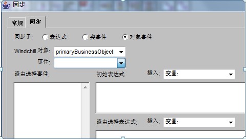

Open the workflow administrator and create ,create a workflow template to test a customerized workflow event on an object:
Without good luck,the event drop-down list can’t be opened in an synchronized robots:
My question is:What’s wrong with the event drop-down list?
