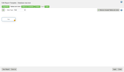

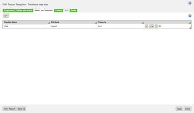

Hi
What is the right way to retrieve the Maximum (Last modified) date in Query builder?
I have tried this option (see picture) but didn't succeed

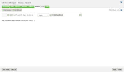

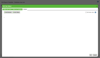

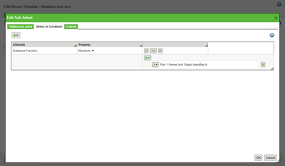

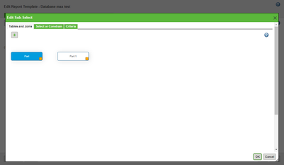

Here's an example of using the Max function. I believe you can only use it in a Subselect.
This query will return info on the Part  with the highest value for "Persist.Info.Object.Identifier.Id"

I'm trying to understand how to use the Database function, so I tried to display maximum of 'Height' (defined as Real Number) ,but I got an error message (see attached picture).
What am I doing wrong?
