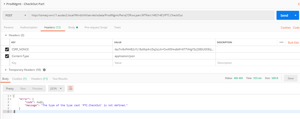

I did some REST 1.5 API tests in Postman and things do look good.
However, I found some problems which I cannot explain. For example, I am unable to do Checkout/Checkin on WTpart.
I created new WTPart and tried to do Checkout via REST call, someting like that:
http://tomazj-wnc11.audax2.local/Windchill/servlet/odata/ProdMgmt/Parts('OR:wt.part.WTPart:1462146')/PTC.CheckOut
Exactly like in Windchill REST Services User’s Guide v1.5, page 167.
I used POST call, I got current CSRF_NONCE.
Return JSON is :
"error": {
"code": null,
"message": "The type of the type cast 'PTC.CheckOut' is not defined."
MS log error is:
2019-06-14 10:58:43,931 ERROR [ajp-nio-127.0.0.1-8010-exec-2] com.ptc.odata.windchill.servlet.WcRestServlet wcadmin - An unexpected REST error occured Type 'PTC.CheckOut' not found.
It looks like there is something wrong with my REST implementation in Windchill. I got v1.5 via 11.0 M030 CPS 15 install.
I authenticate in Windchill as wcadmin.
Any ideas?
Regards.
Solved! Go to Solution.
@TomazJeras this is a documentation error, this should be addressed in the next document release. The correct API to use is
http://tomazj-wnc11.audax2.local/Windchill/servlet/odata/ProdMgmt/Parts('OR:wt.part.WTPart:1462146')/PTC.ProdMgmt.CheckOut
Thanks.
Tomaz
@amarsingh, is this new in the REST 1.5? I'm using an ECAD application and we had everything working with REST 1.2. We needed to upgrade to CPS-15 for some unrelated reasons and now I am seeing the same error messages in the logs from my ECAD application that uses the APIs (instead of using WWGM). I don't have control over what the ECAD application does, and it looks like it's sending the PTC.CheckOut and I'm getting the same error that TomazJeras had. Thanks for any feedback that you might have.
This is rather a documentation gap and an issue. This bound function should be called along with the name space.
I checked REST documentation back to v1.0 and Checkout was everywhere mentioned in /PTC domain. I am currently unable to check this for previous REST versions, but it is possible that they moved CO (and CI) commands to ProdMgmt domain in versions since 1.2, but they forgot to update documentation.
This could explain your behavior that ECAD app worked with 1.2 and stopped in 1.5. I checked What new sections, but didn't find any reference to it.
You should probably contact ECAD app authors.
I also opened PTC Suport Case and Tilo Helmig from PTC explained that "in 1.5 the action was changed from PTC.CheckIn to PTC.ProdMgmt.CheckIn".
Documentation will be updated, but it looks that ECAD app will have to be updated, too.
