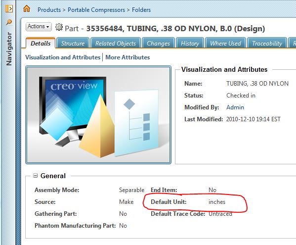

In our case, we have cut to length items such as fuel hoses, plastic tubing, foam strips, edge guards, etc that are bought in bulk, then they are cut to length on the assembly line.
Today we create manual WTpart BOM's because we have not associated our CAD models to the WTparts yet, but getting ready to .
I am trying to figure on how to handle the cut to length components.  Our WTpart default unit is in inches per below which is carried over into our ERP (Oracle).
So I associate the CAD model to the WTpart, I am thinking it will be "image" association because the CAD model will be configured at a different routing each time.  The BOM quantity will show up as 1 instead of the required quantity (such as 30, for 30 inches of tubing).   How do I get it to show up as 30 ?
Any suggestions would be great

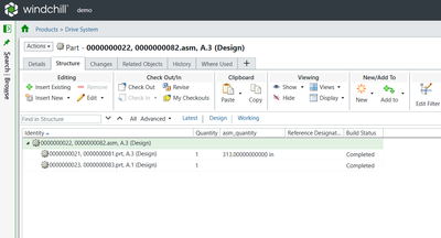

Or you could try something like-
add an assembly driven attribute asm_qunitity
looks something like-
by-
Not sure how ERP will handle it though, that part needs to be checked
@ChrisPLM @bradlawrence
could be helpful
