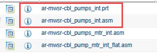

Renaming parts in Creo 9.0 some pointer to old part not released. Can't check in to Windchill without error "part not unique."   Part not in Commonspace or other Workspace.
Resolve:
Now in WC12, you no longer can name an assembly and part the same name as you previously could since the conception of Interlink then Windchill.
4 months and counting and it's all yours, gang,  I certainly won't miss PTC.

By our company naming rules, we never allowed a part and assembly file to have the same name because it led to WTpart linkage issues. Glad PTC has finally closed that hole in functionality with WTparts.

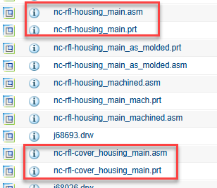

All I can say is this was normal procedure since the early 90's keeping the part and assembly the same name for things like harnessing and inseparable assemblies such as a sheet metal part with pem inserts or plastic parts with untrasonic inserts.
Here's a few of thousands of Windchill examples where we have the same name.

Sounds like you figured out your answer. Well you can have EPMDocuments identified as you show above but the issue with default rules on WTParts. If you drop the extension the two EPMDocument docs will try to create a WTPart of the same number. This is where the error is likely coming from. Since it failed, the object never gets created so you cannot find it, it rolled back. You have complete control of the numbering rules for WTParts in your site preferences. If you want to have it keep the extension you can. You can also change the options on automatically creating WTParts or you can change the default link type from owner to image. Lots of options. Also sounds like you are moving off of Windchill in a few months? Sry to see you go.
