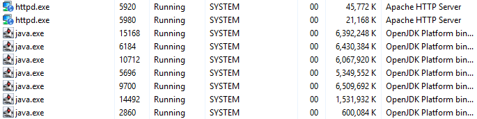

Hardware
I'm sure this is dependent on how many people are connected, but our replica servers don't have nearly the same level of hardware or load placed on them as our production server.  The Windchill process running on a replica server are minimal, and the CPU usage is almost nothing.
For comparison:
Production Server
Replica Server
Vault
This is configurable of course, but by default the only things in the replica vault are what the users at the remote site have requested, or what the users at the remote site have uploaded.  Think of the remote vault as being in between the users and the main server.  The first time someone at a remote site requests something from the main server, it's added to the remote vault and then delivered to the user.  All subsequent requests for that file from that user or any other user at that same site will be served directly from the replica vault.  It's essentially a file cache.  If every single file on the main server was requested by the people at the remote site, then yes, the replica vault would get quite large, nearing the size of the master vault.
