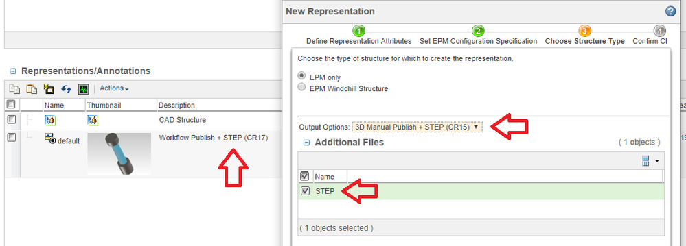

Can I create a STEP file of a part or assembly, with it checked in from common space only ?

No.  You have two options:
  1. Add the object to a workspace, open in Creo (or 3rd party CAD), and save-as to a STEP file.
  2. Have Windchill generate a STEP file during publishing.  (It performs the same steps as above, but on the CAD worker machine.)

Can I choose to create a selected part to be published as a STEP file. I have my change notice ready to submit and want to publish the STEP file for only this notice. Not for every notice that comes next. Are there any setting to do this selectively?

It depends entirely on how your administrators have your system configured.

If this is a one time event, it's probably not worth re-configuring the system.  Just create the STEP file as a WT Doc. and then add it to the change notice.  (I'm assuming you can add WT Docs to change notices...)
If you really want to reconfigure things, I can imagine two possible solutions.  The first is to modify the publish rules so the CAD worker will generate the STEP files during publishing.  These can be configured to generate every time something is published on just when manually requested.  The second solution is to modify the change notice workflow so that it will directly tell the publisher to generate the STEP file on command (do_publish).  This is beyond anything I've done in a workflow, but I'm sure there are others on the community who can help.

Yes, I'm sure that could be done.  The logic to publish something could be added to an expression robot.  Take a look at this section of the documentation:

We've had this in place for ~ 2 years with great success.
Publish rules govern what gets created by publishing for user request vs. check in, schedule, or workflow.  We generate STEP and IGES, and also STL for Creo (not for SolidWorks), rename the resulting files to include the version (e.g. 2623465_prt_A2.stp), and show on /Content/Attachments.
Any user can command the system to generate these files, and then download using only a browser.
