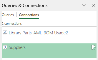

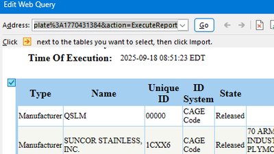

In both cases I use the Excel legacy web data connection to pull down reports to a worksheet for processing. I would love to improve this part so let me know your input here. Running URL below will output report as an HTML table that Excel can feed into a sheet. Always looking for better ways to do this part.
https://<myhostname>/Windchill/servlet/WindchillAuthGW/wt.enterprise.URLProcessor/URLTemplateAction?format=formatDelegate&delegateName=HTML&xsl1=&xsl2=&oid=OR%3Awt.query.template.ReportTemplate%3A<REPORTIDHERE>&action=ExecuteReport

Attached is my template sheet and the VBA code that you can assembly and modify. I deleted the connections but I had two linking to the QMLs I posted this morning. Again, if there are better ways or improvements, please send along.
