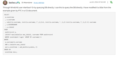

As I don't have admin level access, I could not access the report management section. I used the database query given in one of the links which @Marco_Tosin provided :
Through which i was able to extract users' last login date, but still I need one more column which would show each users access levels (view or write). Do you know how to merge that info with this query?
Strange that you have DB level access but not site admin level access. That should be fixed since this could have been done in 5 mins, Much more complex at DB level but here you go. This is a simplier query and if you do not like the name how the audit record records it, replace with U.name instead of A0.userName. This also is simplier since if there was an audit record of some event, the user must have been logged in so any event will do. Filtering on login events will show you the start of their session, not the end. the View and Print group are your read only users by policy unless you have another definition of read only is.

I used the database query given in one of the links which you provided :
