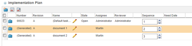

Hi Everyone,
I have 100 pdf, i want to assign all this into individual user's. So i decided to go with Project Management, but i didn't know how i can assign on one shot.
1. Assign the pdf to designer.
2. Once designer is done and deliver that.
3. If there any rework how that same designer can work / if any emergency i can swap into new designer.
Thanks in Advance

you can add as many task as you wish and each task may have a different assigned user and affected pdf

Hi @Amirtharaj_K
Yes, you can crate one task per user and add there the document.

Hi @Amirtharaj_K
You can create the tasks and set the sequence. (if project link module is installed)
I fully understand what you need but, without customization there is not a function that can do what you're looking for by UI in one shot.
You can use loadfromfile, but it is admin function from a Windchill Shell (How to load Parts, Overview of Load Utilities)
