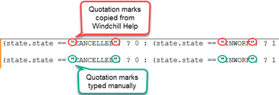

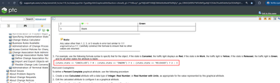

Hi, I know it's been a while since you opened this thread, but I had the exact same issue, and I have recently discovered what the problem was!
If you want to create a "traffic ligh" attribute the normal thing is to go to the WIndchill Help, and copy the example code:
The problem is that the quotation marks of this example code are the reason why you get the message "Value entered in Formula is invalid", although the code is correct!!
I have realised that the quotation marks copied from Windchill Help are different from the quotation marks that you type, and this is the reason of the error!
So just change the quotation marks and the value entered in the formula will work!!!
