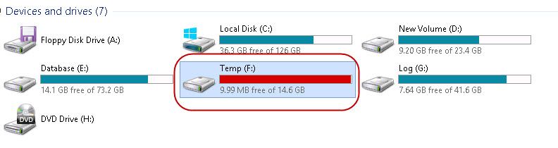

I'm working on my first test upgrade from Windchill 10.2 to 11.0.  We use SQL Server as our database.  I'm on the Update Database Schema phase and task.  I have a question about that how much drive space do I need for the SQL tempdb.  Do I need to have as much room as the size of the database?  I have the drive at about half the size and it filled up that drive to 99.9% and after that happened the CPU spiked and so did the RAM.

By default the tempdb has a property for automatic increase size, I did not notice a large increase its size.
How large is your database?  Mine is close to 40 Gb.  I know that it increases automatically, but I ran out of disk space where the file is located.
In any case you must do a test upgrade and will see the change in its size.

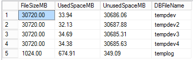

Here is a script to check free space in tempdb:
use tempdb
-- Show Size, Space Used, Unused Space, and Name of all database files
select
        [FileSizeMB] =
                convert(numeric(10,2),round(a.size/128.,2)),
        [UsedSpaceMB] =
                convert(numeric(10,2),round(fileproperty( a.name,'SpaceUsed')/128.,2)) ,
        [UnusedSpaceMB] =
                convert(numeric(10,2),round((a.size-fileproperty( a.name,'SpaceUsed'))/128.,2)) ,
        [DBFileName] = a.name
from
    sysfiles a
order by a.name
Running it right now (in production) almost nothing is being used.  During the upgrade it almost filled up all four of the files.
