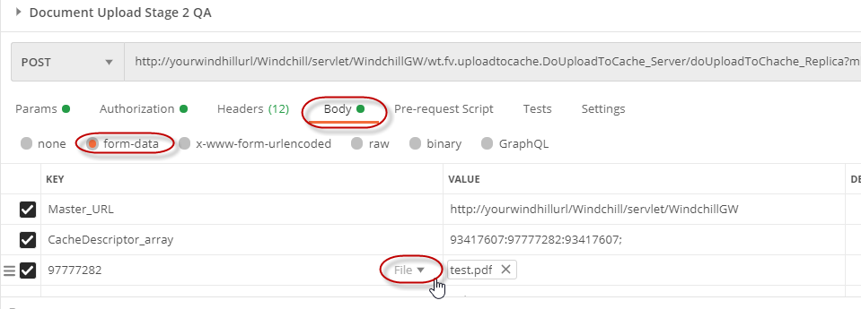

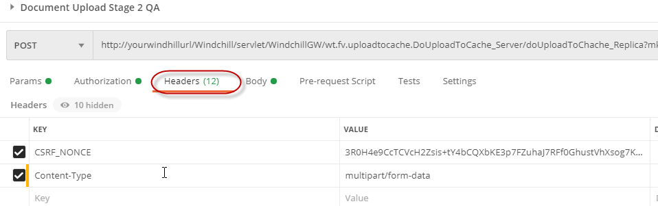

Here an example of C# provided by Postman for the stage 2
var client = new RestClient("http://yourwindhillurl/Windchill/servlet/WindchillGW/wt.fv.uploadtocache.DoUploadToCache_Server/doUploadToChache_Replica?mk=wt.fv.uploadtocache.DoUploadToCache_Server&VaultId=2413044403&FolderId=12386665526&CheckSum=382389780&sT=1605624474&sign=ko2ejJm0QjxduNBL6Jhr75awZHQW0dLuTZ1sDeNs%2Fl5XAmjO23rN8mWrsbtPh0JtKz4UPn%2BoALSzLPgZ%2BZluMw%3D%3D&site=http%3A%2F%2Fyourwindhillurl%3A8585%2FWindchill%2Fservlet%2FWindchillGW&AUTH_CODE=RSA&isProxy=true&delegate=wt.fv.uploadtocache.DefaultRestFormGeneratorDelegate");
client.Timeout = -1;
var request = new RestRequest(Method.POST);
request.AddHeader("CSRF_NONCE", "3R0H4e9CcTCVcH2Zsis+tY4bCQXbgKE3p7FZuhaJ7RFf0GhustVhXsosjdfg7K2HFEzChg2vQUup6Cs11d10QQenR0eqqU59kqoKM0n7Nxjzt3tJsrx3C2rETUA=");
request.AddHeader("Content-Type", "multipart/form-data");
request.AddHeader("Authorization", "Basic Q1QxMTk4MGflDDkkfcnVzMDkyMA==");
request.AddParameter("Master_URL", "http://yourwindhillurl/Windchill/servlet/WindchillGW");
request.AddParameter("CacheDescriptor_array", "93417607:97777282:93417607;");
request.AddFile("97777282", "/C:/test.pdf");
IRestResponse response = client.Execute(request);
Console.WriteLine(response.Content);
In Postman, some screenshots to show how configuring the Header and  Body
If needed I can provide you more detail, don't hesitate to contact me.
