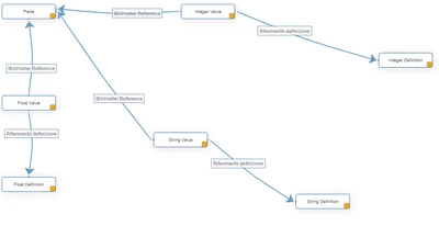

Use Case: I try to have a report which expose only the attributes of a dedicated leave of partslink
Description:
I cannot find in the report criteria the partslink attributes
Depending on the type of attribute defined (string, float, integer) you need to create a report like this but don't expect a row for each attribute if there are multiple values, because the total displayed is the multiplication of the possible values for each type of attribute in the report.
In my case it is 168 rows for each WTPart

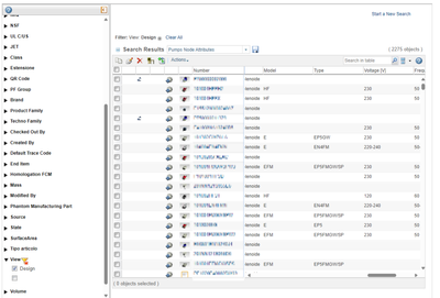

it's a pitty.
What I'm looking for is to create and send a report exactly as the attached search results.
BR
Gianpaolo
