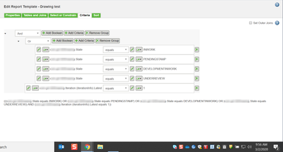

On the Criteria tab, if you add a criteria that <business object>.State equals Released, that will pull in only released objects.  In addition, if you set the criteria <business object> (iterationInfo).Latest to "Yes," that will return only the latest iteration.
I am building a report that looks for several states, but excludes released and those like it.
This sounds like this method will show all the latest of every revision.  Is that correct?
"When you reward an activity, you get more of it!"
ringo1
(To:LawrenceS)
That is correct; given that the lastest meets your lifecycle state criteria.  In my case; I am excluding released, so if my Rev A is released and my Rev B is in work, I pull back the latest non-released version.
Have to address Revision and Iteration separately.
Latest Iteration can be selected directly.
Revision is convoluted because you can make any sequence of strings or integers your custom Revision series.
