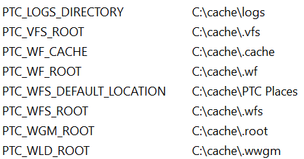

  • The folder specified by PTC_WFS_ROOT and Tools > Windchill File System Management > Windchill Folder Full Path should not be the same folder. but default it takes the Windchill folder location path.
I found it necessary to explicitly set all the environment variables to someplace that is definitely not shared because everything would default to a OneDrive location if left to it's own devices.
PTC_WFS_DEFAULT_LOCATION sets the "PTC Places" location (although perhaps this is 12+ versions according to CS353857 ?) for your Windchill Folder Full Path.
AutoCAD, I don't think, needs all of those set.

Where are your environment variables pointing right now?
It'd be best to create a cache folder somewhere on C:\ and point the 4 variables below to that folder set you create.
PTC_WF_ROOT C:\myCache\.wf
PTC_WFS_ROOT C:\myCache\.wfs
PTC_WGM_ROOT C:\myCache\.root
PTC_WLD_ROOT C:\myCache\.wwgm
The other thing to keep in mind if you have Creo running is that the Creo cache locations should be separate from your non-Creo cache. If you have a workspace you created with Creo and put AutoCAD files in there and then with the Workgroup Manager try to go to the same location, Windchill will know of the files but won't be able to necessarily get them since it's cache is pointing to a different physical location. That may also result in a "invalid file" error and often results in a workspace corruption.

Actually issue got resolved after reinstalling OS also setting environment variable in client machine recently. But this issue has been raised from most of the production user team and its repeated two to three days once from some machines.
Suddenly why this behavior are getting from WGM Autocad & what may be the root cause ? .
Do you have an admin installation that sets the environment variables for all users?
Is the local cache in a OneDrive (or otherwise shared) folder?
Do you have anti-virus exclusions set? CS50545 helped us out on this front and really would be the last thing I can think of.

for question 1 : WGM  have installed in non admin user level, so EV set for only the user level.
for question 2 ; local cache is shared [C-drive] from pc.
for question 3 : need to check...
When you say "local cache is shared [C-drive] from pc" do you mean to say that the cache folder your environment variable is pointing to is managed by some other sharing service (like OneDrive)? If yes, that may be causing your issue...
Or "shared" as in "shared between users"? As I understand it, the WGM doesn't allow shared users on a machine unless you're in Windchill 13. That has more to do with dlls. For this you'd get a different error at start up of WGM.
User environment variables should be fine, I think.
