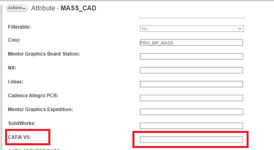

I already have that setup. I am fairly confident this is setup correctly because CATParts have the correct mass in the workspace. However the mass for all CATProducts is 0. Screenshot from Type and Attribute Management.
Check this option in wgmclient.ini and check then check what kind of bodies are in your CATIA product model.
expose.mass.properties.only.main.body=

expose.mass.properties.only.main.body is commented out so default to No
I have tried setting this to Yes however mass still comes in as 0.
As far as I can tell there are no 'bodies' in the CATProducts. The components are CATParts. The same CATParts that come in with the correct mass.
