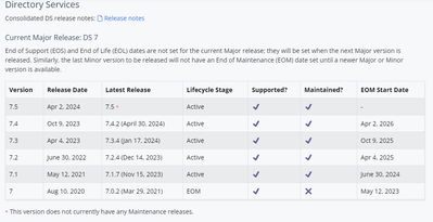

Use Case: I am installing the WC 13 and need to install the Directory server OpenDJ on windows environment. Needs exact version of OpenDJ to install.
Description:
As per the Article - CS397683 it says to install the OpenDJ 3.5, which on page shows out of support. When checked further there are no downloads available on " https://backstage.forgerock.com/ " .
I can see the lates version of OpenDJ has been released and it is supported as per the forgerock.com.
Experts can you confirm which OpenDJ is recommended by PTC.
Which Open version I should use, It will be great help if someone can guide on this.

Windchill supports any ldapv3 compliant data store. As of 12.0.2.x, PTC no longer supplies, nor suggests a DS/DJ version. I would use one that is supported and meets your organizations security requirements, and configure it for ldaps.

So any latest version of OpenDJ can be used? I am setting up the Dev environment and would need to use the Directory server as of now.  since the Article suggest using version 3.5 (which on site says its End of support) so really confused about the version of OpenDJ  to be used.

The link in the case is out of date. No one update it during a time so there is a link to version 3.5
It is up to you what version you use.
DS that supports ldapv3 should work.
