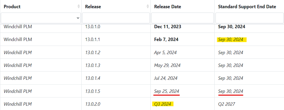

Does anyone know why there is no overlap between the support end dates for Windchill 13.0.1.x and 13.0.2.x?  Why would PTC plan to release something that 5 days later will no longer be supported?
It really seems like each subsequent CPS for 13.0.1.x should push the support end date a little further out.  At a minimum, there should be a decent amount of overlap (at least a year) between when 13.0.2.0 ships and when support for 13.0.1.5 ends.
None of our customers want to risk switching to Windchill 13.0.1.x with the support end date so quickly approaching.  Everyone is upgrading to 12.1 instead, which is unfortunate because going directly to 13 would have avoided a second upgrade project in the future (assuming they still go to 13 at some point.)

That is a revised date for the release of 13.0.2. It used to say Q2 2024.
I never plan on installing a Windchill initial release XX.0.0 or the first release X.0.1 because they typically have short term life.
I was initially looking at going from 12.0.2 to 13.0.2 but with the support window closing on 12.0.X of June 30, 2024 and the closeness of the 13.0.2 release I am working on using 12.1.2 for the next 12-15 months. Then I will see where PTC is with 13.0.2 or 14.0.2.
March 15, 2024
With the release of 13.0.2 now being delayed, there is a "chance" that the end of support for 12.0.2.x may be extended. But that is speculation at best.

Stated another way, there is no version of Windchill available today that will not need to be upgraded again before the end of the next year (in order to stay on support).  This is a problem for many of our customers right now.  There should always be something currently available that will be supported for at least three years.  Right now, there is nothing.
March 22, 2024
There should always be an overlap of the long-term supported versions end dates of at least 6 months.
April 4, 2024
13.0.2 is now slated for release July 2024. No changes to end of support dates for prior releases.
