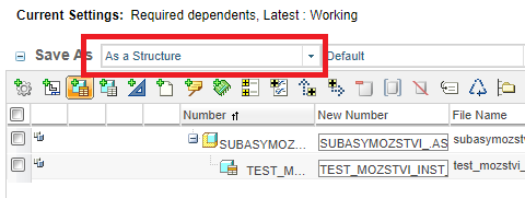

Can i have a thumbnail view in Windchill Browser? For example, i'm trying to "save as" an assembly, but all the components are showed as a list, and it is hard to remember the name of every component that i want to "save as" too, it would be great if i could see the components in thumbnails.

Hi @Fadel
Yes you can add it in the Folder table,
But the Thumbnail Navigation is not available in the save as table.
@luiz.hnm btw for better overview you can set the table to a structure view

not sure if I have understood your request , in the folder browser you can add thumbnail navigation to see the viz when hovering mouse

Hi @Fadel

Hi @HelesicPetr , Hi @luiz.hnm , unfortunately this feature is not available yet , there is an Idea submitted on this ,https://community.ptc.com/t5/Windchill-Ideas/Ability-to-include-thumbnail-navigation-in-Save-As-objects-table/idi-p/702167
you can add a comment  and vote for it to increase visibility.

Hi @Fadel
Yeah I know. I've already voted for it many years ago 😄
PS: if anyone can please vote for it. There are not so many votes. It will be archived in the end of this year.
