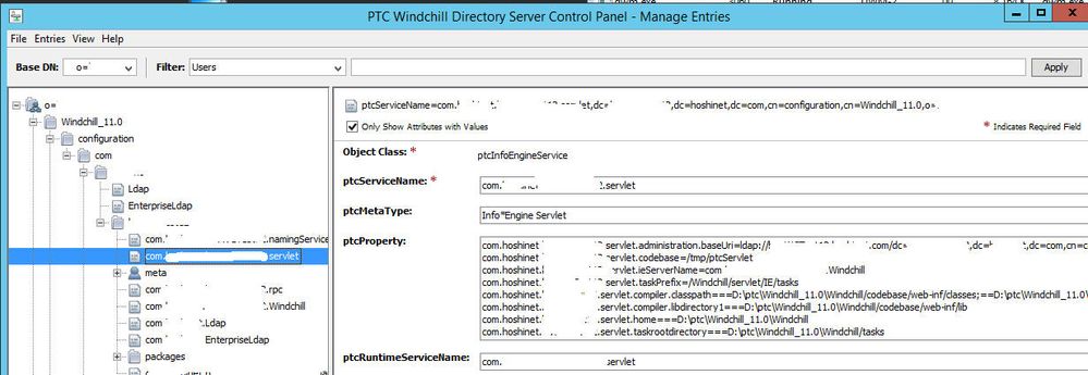

Once you have rehost down they go and change it.  Granted the last rehost I needed to do was 4 years ago but I have another test server and am trying to rehost my production server.  I installed SQL Server and installed the database portion of Windchill. Imported my database and performed the action after import.  Then I copied the Windchill load point and vault over.  Then I set up my rehost.properties file and ran the rehost.  It says it completed successfully.  Windchill will not start and disconnects WindchillDS in the process.  I'm on 11.0 m030.  The last time I did this I was on 10.2.  Does anyone have a document with the steps needed for doing this?  I'm guessing part of it is my LDAP connection.  Any suggestions or help would greatly be appreciated.  I just wish this wasn't always changing.  My instructions should be good to get it working again, but I guess going from Rehost Utility 3.0 to Rehost 11.0 is a major undertaking. 😞
After working with my VAR, we found were the issue was.  In WindchillDS, there was one line that still pointed to the old server name even though all other references were changed to the new server name.  We found it by exporting out the LDIF and searching for the old server name in Notepadd++.  Then we went into the manage entries and changed it.

I do have the 11.0 rehost files.  All of my issues are around getting the test Windchill back online.  First I get an Ldap 53 error and then an Ldap 49 error after I thought I fixed the first error.  Then I try to fix that error and go back to the Ldap 53 error.  That's good that you got it working, not so good at how long or that the development didn't work.  I copied the directories and tried to do a rename rehost.  I'm hoping that I do not have typo somewhere.
