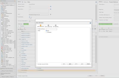

I want a new attribute in the new user creation tab. when I tried to add the attributes, I only received the "Alias & Calculated" there I couldn't see the global attributes.
If anybody knows how to add the attributes in new user creation, please support me.

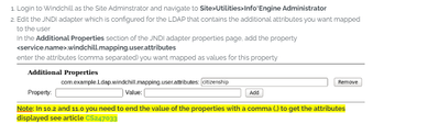

I didn't see <service.name>.windchill.mapping.user.attributes like the below image.

  1. Login to Windchill as the Site Adminstrator and navigate to Site>Utilities>Info*Engine Administrator
  2. Edit the JNDI adapter which is configured for the LDAP that contains the additional attributes you want mapped to the user
    In the Additional Properties section of the JNDI adapter properties page, add the property <service.name>.windchill.mapping.user.attributes
    enter the attributes (comma separated) you want mapped as values for this property
    Note: In 10.2 and 11.0 you need to end the value of the properties with a comma (,) to get the attributes displayed see article CS247033
