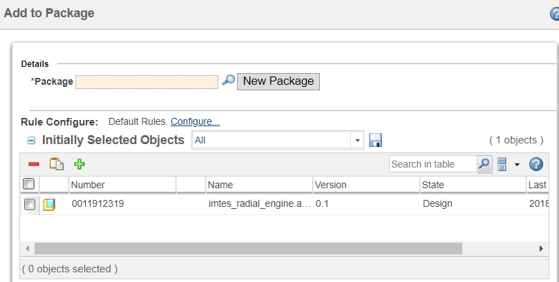

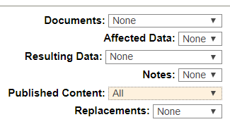

First: make sure that on the collection rules you configure that secondary content is in fact included
Make sure you have a package selected (or create a new package) and then select "Configure"Make sure you have a package selected (or create a new package) and then select "Configure"This is on the right-hand size. As long as published content is set to all, the package will collect all secondary information.This is on the right-hand size. As long as published content is set to all, the package will collect all secondary information.
Second: when locking the package, make sure to include the file extensions you'd like to be included.

I see that it is not attaching the content files and your initially selected object is a Creo assembly. Was this associated to a wtpart? Just curious because this is the case where it would not include the content for me. If it did not have an associated wtpart, it would include the associated content.
Dobrisa
(To:JoshuaHouser)
We don't use WTParts in most of our environment. I added a Creo assembly (EPMDocument) to the package. Some of the documents had published content at the time and some didn't.
